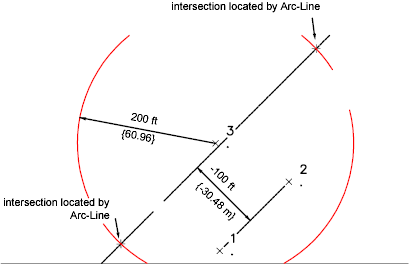

You can calculate the intersection(s) of a line established by two points, and an arc established by a radial point and radius.
Arc/Line. ARCLN [point] [radius] [point 1] [point 2] [offset]
NE 1 100 100
NE 2 200 200
NE 3 250 100
ARCLN 3 200 1 2 -100
! INTERSECTION # 1 NORTH:387.066972 EAST:245.645615
! INTERSECTION # 2 NORTH:104.354385 EAST:-37.066972
Intersections are located between an arc radius of 200 with the center at Point 3 and a line drawn between Points 1 and 2 with an offset distance of 100 to the left.
