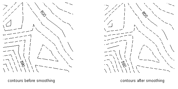

Surface smoothing resolves a problem associated with individual contour smoothing where the smoothing is applied to individual contour lines without regard to adjacent contours, which sometimes creates overlapping contours.
Surface smoothing adds points at system-determined levels using Natural Neighbor Interpolation (NNI) or Kriging methods, which results in smoothed contours with no overlapping.
Only Triangulation surfaces support surface smoothing.
Surface smoothing results in smoothed contours with no overlaps:
