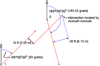

You can find the intersection point between two infinite lines from existing points.
After an intersection is found, you can save it by specifying a new point number.
Whole Circle Bearing/Whole Circle Bearing. AZAZ [point 1] [whole circle bearing 1] [offset 1] [point 2] [whole circle bearing 2] [offset 2]
NE 1 100 100
NE 2 200 200
AZAZ 1 50 10 2 183.3333 -20
! INTERSECTION # 1 NORTH:186.991377 EAST:219.229524
An intersection is located between a whole circle bearing of 50.000 drawn from point 1 with an offset distance of 10 to the right, and a whole circle bearing of 183.3333 drawn from point 2 with an offset distance of 20 to the left.
| Parameter | Definition |
| point 1, point 2 | The existing point identifiers defining the beginning of the whole circle bearings |
| whole circle bearing 1, whole circle bearing 2 | The whole circle bearings for the lines from the existing points (point 1 and point 2). Whole Circle Bearings establish a direction for each vector and are expressed in current angle units. |
| offset 1, offset 2 | The offsets from the lines. This acts as if the lines are moved X feet or meters to the left or right. An offset to the right is a positive number, and an offset to the left is a negative number. If you do not want an offset, then use zero. |
