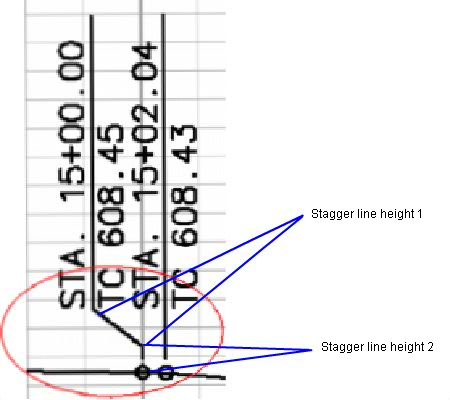

Use the label height staggering options to avoid label collisions in densely populated data boxes. The staggering options are available through the Profile View Properties or the AutoCAD Properties palette.
Stagger label line height
The following workflow describes how to stagger profile view labels, and the same concepts can be applied to setting up the section view labels.
