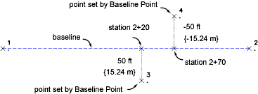

You can create a new point by specifying a station on a baseline, and an offset distance in reference to an existing baseline, with the Station/Offset command.
Chainage/Offset. BL TP (point 1) [station] (offset) (description)
NE 1 1000 1000
STN 1
ZD 2 100 121.92
BL IS 1 2 0
BL TP 3 220 15.24
! POINT 3 NORTH: 946.7889 EAST: 1214.0113 LEVEL:<Null>
BL TP 4 270 -15.24
! POINT 4 NORTH: 968.1235 EAST: 1268.5445 LEVEL: <Null>
Point 3 is offset a distance of 15.24 to the right of the baseline at Station 2+20 and Point 4 is offset a distance of 15.24 to the left of the baseline at Station 2+70. Distances are in the current units, unless you type a qualifying suffix.
Baseline created at an offset distance
