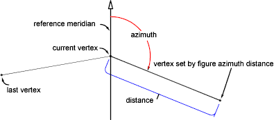

Create a new vertex from an existing vertex in the figure using a whole circle bearing and distance. At least one vertex must exist in the figure for this command to work.
Survey Command Window. FIGURE AZ-DIST [whole circle bearing] [distance]

The following illustrates the Whole Circle Bearing and Distance command:
Command Synonym
FIG ZD
| Parameter | Definition |
| whole circle bearing | The desired whole circle bearing from the current vertex to the new vertex. Enter this value in the current survey database angular units, either DMS, grads, decimal degrees, radians, or mils. |
| distance | The distance from the current vertex in the figure to the new vertex. Enter this value in the current survey database distance units. |
