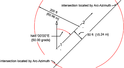

You can find the intersection points between an arc and a line that is established by a point, whole circle bearing, and offset.
Arc/Whole Circle Bearing. ARCAZ [point] [radius] [point 1] [whole circle bearing] [offset]
NE 1 100 100
NE 2 200 200
ARCAZ 2 200 1 50 50
! INTERSECTION # 1 NORTH:274.411634 EAST:385.641883
! INTERSECTION # 2 NORTH:30.099879 EAST:94.482471
Intersections are located between an arc radius of 200 with its center at point 2 and a whole circle bearing of 50.0000 drawn from point 1 with an offset distance of 50 to the right.
