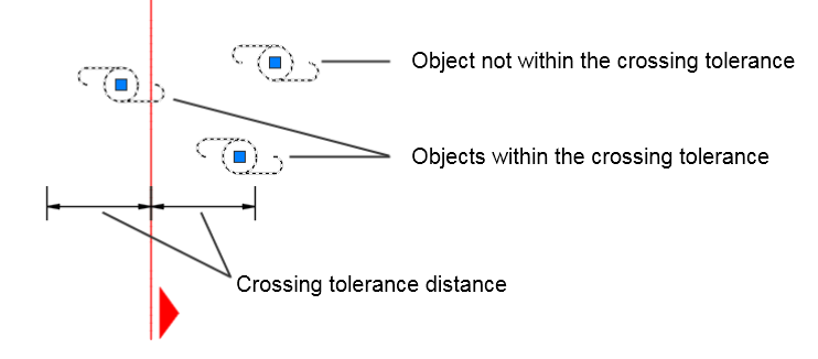

Specifies the distance within which an object must be from a sample line to be displayed as a crossing.
For example, if this value is set to 1 feet, an object's centroid grip can be within one feet of the sample line and still be displayed as a crossing in a section view.
If this value is set to zero, the object's centroid grip must be exactly on the sample line in order to be displayed as a crossing in a section view.
The maximum value that you can specify for this setting is 15 feet or 5 metres.

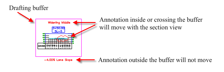

Drafting elements that are added within or crossing section view drafting buffers are bound with the section views and are moved with the section views if they're moved.
For more information, see About Section View Drafting Buffers.
Use the following settings to specify defaults for the drafting buffer margins when creating section views.
Specifies the amount of space for the drafting buffer above and below the section view grid.
Specifies the amount of space for the drafting buffer to the right and the left of the section view grid.
