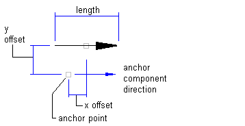

Add an arrow to a label style to indicate direction.
Direction arrow properties
