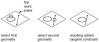

Applying a straight constraint

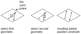

Applying a parallel constraint

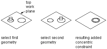

Applying a concentric constraint

Can be defined between curved geometry (such as a circle or arc) and either another curved geometry or a line. Makes two curves tangential to one another, even if they do not physically share a point. Tangency is commonly used to constrain a line to an arc or circle.
Can be defined between pairs of geometry with a direction, such as lines. Causes two or more lines to be parallel to one another.

Can be defined for any combination of circles and points. Fixes the centers of the geometry to the same location. Common uses include circle to circle, where the center of both circles is the same; circle to point, where the point lies at the center of the circle; and point to point, where the points are the same.
