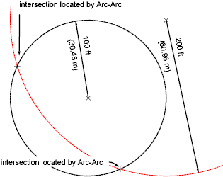

You can calculate the intersection(s) of two arcs, each defined by an existing center point and a radius.
To calculate the intersection of two arcs in the Survey Command Window

To calculate the intersection of two arcs, using the survey command language
- In Toolspace, on the Survey tab, right-click the network to edit, and click Survey Command Window.
- At the Command line, enter:
ARCARC [point 1] [radius 1] [point 2] [radius 2]
Command Line Example
NE 1 100 100
NE 2 200 200
ARCARC 1 100 2 200
! INTERSECTION # 1 NORTH:8.856217 EAST:141.143783
! INTERSECTION # 2 NORTH:141.143783 EAST:8.856217
Intersections are located between an arc radius of 100 with a center at Point 1 and an arc radius of 200 with its center at Point 2.
