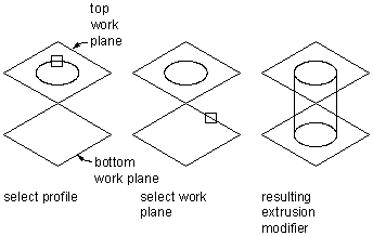

A plane extrusion sweeps a profile between the profile itself and a specified work plane. If the work plane is a reference work plane, the extrusion is updated when the work plane is moved.
Applying a plane extrusion modifier

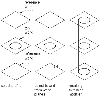

A from-to extrusion sweeps a profile between two work planes.
Applying a from-to extrusion modifier

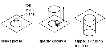

A blind extrusion sweeps a profile a specified distance along its normal, or perpendicular axis. You can flip the extrusion to sweep the profile in the opposite direction as the default normal.
Applying a blind extrusion modifier

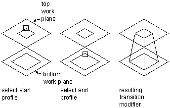

A transition modifier creates a transition body between two profiles. A transition includes both a start and end profile, which cannot be in the same work plane. Point references are useful to ensure that the profiles align between work planes; however, the centers do not need to align.
Applying a transition modifier

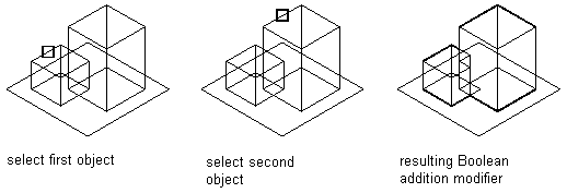

A Boolean add modifier combines two features to create a single feature. This modifier assumes a basic concept of addition: that geometry inside other geometry, when added together, is removed. This modifier is helpful when creating models of parts that are placed in your drawing exactly as they were created in the model.
Applying a Boolean add modifier

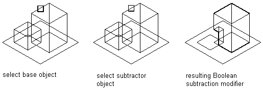

A Boolean subtract modifier subtracts one or more features from another to create a new feature. The Boolean subtract modifier uses a basic formula when creating the resulting feature: that the subtractor objects are removed from the base object. To see results in the model, the subtractor features must intersect with the base feature. When no intersection of features exists, the subtractor features are removed from the base feature with no visible change in the model.
Applying a Boolean subtract modifier
