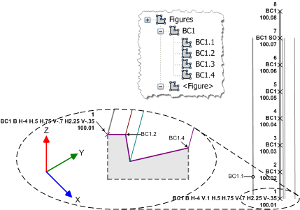

The following illustration shows an example using the codes for Horizontal Offsets, Vertical Offsets, and Stop Offsets:
1,500,490,100.01,BC1 B H-4 V.1 H.5 H.75 V-.7 H2.25 V-.35
2,500,500,100.02,BC1
3,500,510,100.03,BC1
4,500,520,100.04,BC1
5,500,530,100.05,BC1
6,500,540,100.06,BC1
7,500,550,100.07,BC1 SO
8,500,560,100.08,BC1
