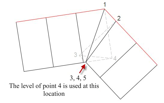

The level value that is used for the corner after bowtie resolution is obtained from one of the inner points of the bowtie as shown in the following illustrations.
The following illustration represents a corner prior to clearing the bowtie. The corridor baseline is shown in red.
The following illustration represents a corner after clearing the bowtie.
Points 3 and 4 are moved to the location of point 5 and the level of point 4 is now used in that location. The locations and levels of points 1 and 2 are unchanged.

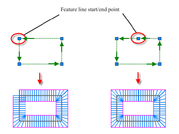

Corner cleanup does not get applied at the end point of a closed feature line-based corridor if the start and end of the feature line meet at the corner, as shown in the following illustration on the left.
To work around this, it is recommended that you draw the feature line so that it starts and ends at a location other than a corner as shown in the following illustration on the right.
