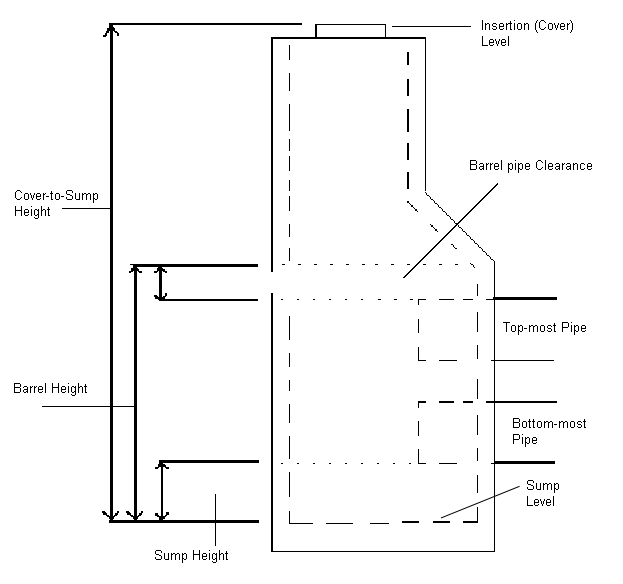

- Sump and sump depth. Sump refers to the bottom area or chamber on the inside of a junction structure, such as a gully. The sump area is sometimes used as a reservoir to catch debris. Sump depth refers to the distance from the bottom of the inside of the structure to the lowest invert of all pipes connected to it. The sump depth for a particular type of structure can vary according to design requirements. Manholes typically have no sump depth.
The following illustration shows the locations of components on a typical junction structure.
