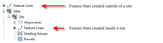

Feature lines can exist outside of a site or within a site.
Feature lines outside of a site are shown in a top-level Feature Lines collection in Prospector. Feature lines inside a site are shown within the Site collection in Prospector.
A black dot glyph indicates a feature line in the collection.
