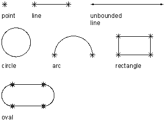

Part Builder provides nine types of geometry you can use to build the model:
Defined by an X and Y coordinate.
Defined by a position and a direction; constrained by a start point and endpoint.
Defined by a position and a direction; infinite in length because it has no constraining start point or endpoint.
Defined by a center point and a radius.
Defined by a center point and a radius; constrained by a start point and endpoint.
Defined by lines and points that are constrained to maintain start points and endpoints for each side and perpendicular angle.
Defined by lines, arc, and points that are constrained to create two arcs straight to two lines, with defined start points and endpoints.
