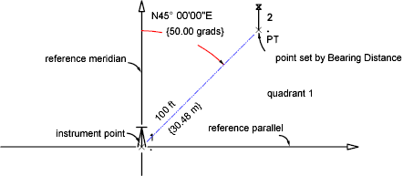

The following example illustrates using the BD command when the units are set to feet:
NE 1 100 100
STN 1
BD 2 45 1 100 TP
! QUADRANT BEARING: N 45-00-00 E DISTANCE: 100.0000
! POINT 2 NORTH: 170.7107 EAST: 170.7107
! LEVEL: <Null>
This creates point 2 at the quadrant bearing and distance specified.
Point created with the BD command:
Point 2 is located by turning a quadrant bearing of 45°0'0" (50 grads) in Quadrant 1 (NE) at a distance of 100 feet from the instrument point with the description TP.
