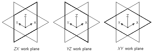

Part Builder provides three default work planes that intersect at the origin of the X, Y, and Z axes. The default work planes help you to get started with modeling a part. Generally, it is best to start your modeling in the top work plane, and add others as needed. You can add work planes at any time during the modeling process. Each work plane has its own internal coordinate system. Work planes can be created on any plane in the current user coordinate system (UCS) or in the World Coordinate System (WCS).
The following preset work planes can be added to a model from the Create Work Plane dialog box:
Creates the standard ZX, YZ, and XY work planes of the WCS.

Viewing default work planes
