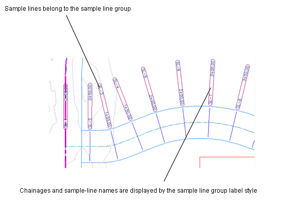

Sample lines cross an alignment to a specified distance to the left and right. Typically, sample lines are created at given chainages along a horizontal alignment.
When you create sample lines along an alignment, section objects are also created for a specified set of existing or proposed surfaces, corridor models, or pipe networks. Each sample line's default styles and sample objects are specified through a sample line group. Other sample objects may be added to the sample line group after the sample lines have been created. To plot the sections in the drawing, create individual section views or multiple section views.
A group of sample lines

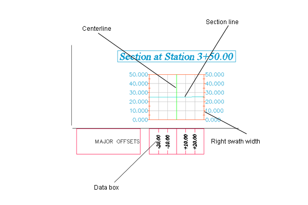

Section view of a sample line
