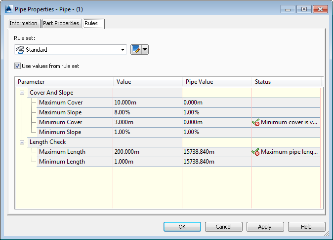

The following illustration is an example of the Rules tab on a pipe in a drawing. In this example, the Minimum Cover and Maximum Length properties for this pipe display with descriptive rule violation text
in the Pipe Value column because they violate the design criteria specified in the Value column. Note the rule violation descriptive text that is displayed in the Status column; for example, “Minimum pipe cover exceeded” and “Exceeds the maximum pipe length by”.
