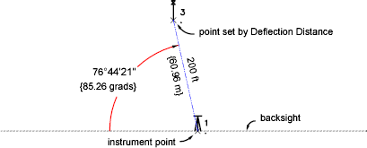

DD 3 85.2657 60.960
! WHOLE CIRCLE BEARING: 385.2657 DISTANCE: 60.9600
! POINT 3 NORTH: 159.3345 EAST: 86.0167
! LEVEL: <Null>
Points created using the DD command:
Point 3 is located by turning a deflected angle of 85.2657 right from the extension of the backsight line at a distance of 200. Angles and distances are in the current units, unless you type a qualifying suffix.
