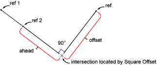

You can determine the offset, distance, and intersection point where a right angle would be projected onto an infinite line (defined by two points). After an intersection is found, you can save it by specifying a new point identifier.
Square Offset. Autodesk Civil 3D determines the offset distance of the point (entered in step 5) from the line established by the first two points. This establishes one known side distance and two known side directions. Using this information, Autodesk Civil 3D calculates the corners of a square and creates the corner of the square offset from the line (established in steps 3 and 4) at the same distance as defined by the point entered in step 5.
SQ [reference 1] [reference 2] [reference]
The following example shows a valid entry using the Square Offset command:
SQ 302 303 501
This example finds the point that creates a right angle between the line from point 302 to point 303 and point 501.
SQ 13 14 501
This example finds the point that creates a right angle between the line from point 13 to point 14 and point 501.
The Square Offset command lists the ahead distance and offset distance to the intersection point.
| Parameter | Definition |
| reference 1 | The existing end point on the vector. It can be any type of point, including a figure point. |
| reference 2 | The existing start point on the vector. Ref 1 and Ref 2 establish a direction on the vector. |
| reference | The point off the vector. The intersection point creates a right angle between the vector and this point. |
