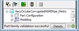

Upon successful completion of these procedures, the part is validated and the status bar is updated with a message indicating if the part validation is successful.
Part is valid

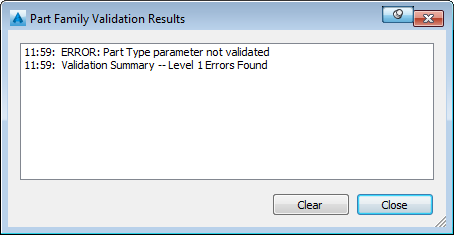

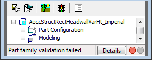

If you have errors in your model, the status bar message displays that the part validation failed, and a dialog box is displayed listing the errors. Review the errors, make necessary modifications, and repeat this step until validation is successful.
Part is invalid
resulting error dialog box when part is invalid
