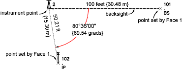

F1 VA 101 0 30.480 100 BS
! WHOLE CIRCLE BEARING: 101.6126 DISTANCE: 30.4800
! POINT 101 NORTH: 199.2280 EAST: 230.4702
! LEVEL: <Null>
F1 VA 102 89.5370 15.304 101.2052 IP
! WHOLE CIRCLE BEARING: 191.1682 DISTANCE: 15.3013
! POINT 102 NORTH: 184.8457 EAST: 202.1159
! LEVEL: <Null>
Points created Face1 command:
Point 101 is located by turning a horizontal angle of 0 right from Face1, and a vertical angle of 100 at a distance of 30.480 from the instrument point with the description BS.
Point 102 is located by turning a horizontal angle of 89.5370 right from Face1, and a vertical angle of 101.2052 at a distance of 15.304 from the instrument point with the description IP. Angles and distances are in the current units, unless you type a qualifying suffix.

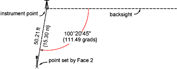

F2 1 200
F2 VA 101 311.4954 15.30 301.0355 IP
! WHOLE CIRCLE BEARING: 213.1080 DISTANCE: 15.300
! POINT 101 NORTH: 198.2901 EAST: 199.6429
! LEVEL: <Null>
Points created Face2 command:
Point 101 is located a distance of 15.30 from the instrument setup at an observed angle right from the backsight of 311.4954. The actual physical angle turned is 111.49, with a vertical angle of 301.03. The description for the point is IP. Angles and distances are in the current units, unless you type a qualifying suffix.
