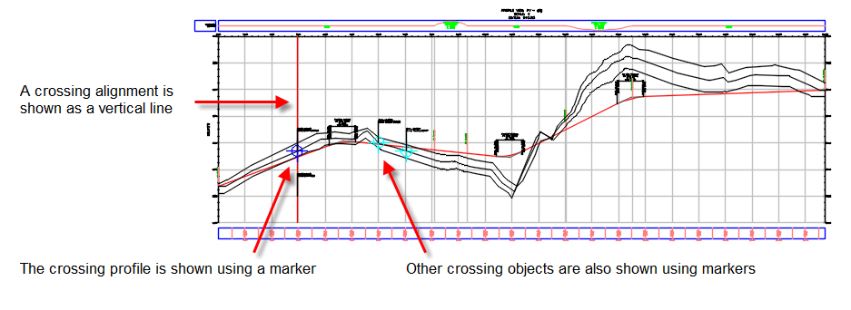

You can add crossings to profile views to identify where linear objects cross the profile relative to the parent alignment.
Use the Add Crossing To Profile View command to add crossings and labels to profile views for the following types of objects:
When you add crossings to a profile view, you specify which marker and label styles to apply to the crossings. You can set up unique styles for each type of crossing object so that you can display and label them differently.
Crossing alignments are shown as vertical lines in the profile view because they don't have levels, but you can specify a level value for the crossing alignment labels.

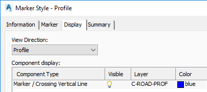

Marker styles are used to control the appearance of crossing objects in profile views. The appearance of the marker style is controlled on the Display tab of the Marker Style dialogue box. Select Profile from the View Direction list to review and edit how the marker style is configured for profile view. There is a single component which controls the display of both the marker (which is used for displaying crossing profiles, feature lines, survey figures and 3D polylines) and the crossing vertical line (which is used for displaying crossing alignments).
