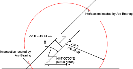

You can calculate the intersection between a line and an arc. The line is established by a point, quadrant bearing, and offset.
Arc/Quadrant Bearing. ARCB [point] [radius] [point 1] [quadrant bearing] [quadrant] [offset]
NE 1 100 100
NE 2 200 200
ARCB 2 200 1 50 1 -50
! INTERSECTION # 1 NORTH:372.285978 EAST:301.575300
! INTERSECTION # 2 NORTH:98.424700 EAST:27.714022
Intersections are located between an arc radius of 200 with its center at point 2 and a quadrant bearing of 50.0000 drawn from point 1 with an offset distance of 50 to the left.
