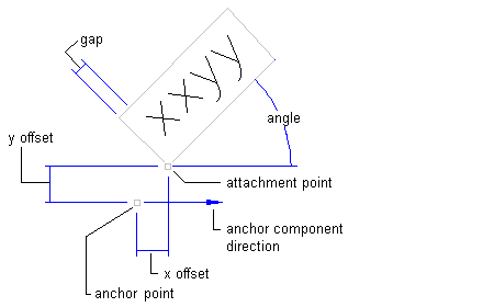

Label component position is defined by specifying an anchor component, an anchor point, and an attachment point. Rotation angles and X and Y offsets are applied in relation to the anchor component and anchor point.
The following illustration shows how these points work together to position the label component (the rotated text in the illustration):
Anchor and attachment points for text component
The anchor is on a line (the anchor is set to Feature and the anchor point to Label Location). The attachment point on the text is set to Bottom Left. Note how the X and Y offsets, angle, and border gap all affect how the label is positioned relative to the attachment and anchor points

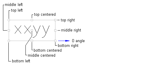

The following illustrations show the different points on label components that can be used either as anchor points or attachment points.
Anchor and attachment points on text component

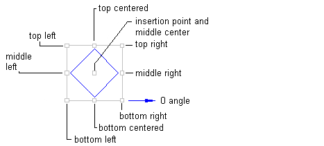

Anchor and attachment points on a block component

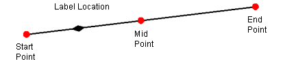

There are four line label anchor points that you can use to attach labels to: start, end, middle points and label location. The label location anchor can be dragged anywhere along the line.
Line label anchor points

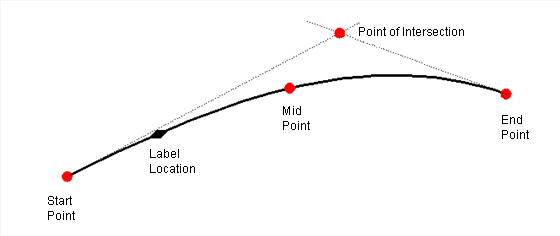

For transition labels, in addition to the label location, start, end, and middle points anchors, there is an Intersection Point anchor.
Transition label anchor points

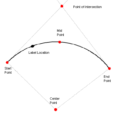

With curve label anchors, you can attach a label to the center point of the arc.
Curve label anchor points
