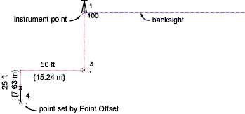

Create a new point by offsetting the last point you created by a given distance.
TP OFFSET (point) [offset] [ahead] (description)
NEZ 1 1000 1000 30.480
AZ 1 2 100
STN 1 1.585
BS 2
AD 3 100 30.480
TP OFFSET 4 15.240 7.620
! WHOLE CIRCLE BEARING: 224.2238 DISTANCE: 41.0350
! POINT 4 NORTH: 961.9000 EAST: 984.7600
! LEVEL: <Null>
Point 4 is located at an offset distance of 15.240, and an ahead distance of 7.620, from point 3.
Point created by offset
