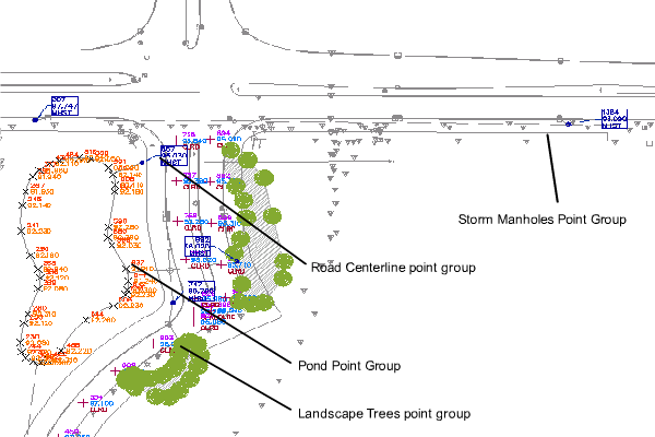

You can use point groups to organize points and to control their appearance in a drawing. Point groups reference the point data directly and are responsible for drawing the points. Point groups have an override that forces all points in the group to use both that group’s preferred point style and point-label style, rather than the styles assigned to the individual points.
Point groups showing different uses of point styles
