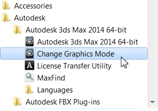

Tip: You can also change the graphics driver when you start 3ds Max by going to the Windows Start menu and choosing Programs Autodesk Autodesk 3ds Max 2018 [installed version] Change Graphics Mode.
In addition, you can specify the graphics driver when you start 3ds Max from the command line.
