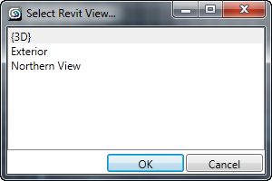

- Select Revit View
- For RVT files, click to open a list that lets you choose the camera view to load into
3ds Max.
This button is not available if there is only one camera in the RVT file, or if the file is an FBX file.
