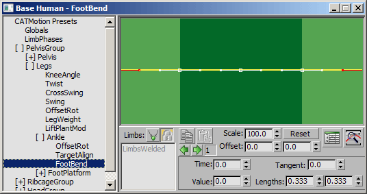

This is a CATMotion Controller used in the animation of Ankles in 3ds Max CAT.

Foot Bend Key 1
 <CATFootBend>.KEY1Val : float
<CATFootBend>.KEY1Time : float
<CATFootBend>.KEY1Tangent : float
<CATFootBend>.KEY1InTanLength (Key1InTanLen) : float
<CATFootBend>.KEY1OutTanLength (Key1OutTanLen) : float
Get/set the In Tangent Length, Out Tangent Length, Tangent value, Time and Value of the first key.
Foot Bend Key 2
 <CATFootBend>.KEY2Val : float
<CATFootBend>.KEY2Time : float
<CATFootBend>.KEY2Tangent : float
<CATFootBend>.KEY2InTanLength (Key2InTanLen) : float
<CATFootBend>.KEY2OutTanLength (Key2OutTanLen) : float
Get/set the In Tangent Length, Out Tangent Length, Tangent value, Time and Value of the second key.
Foot Bend Key 3
 <CATFootBend>.KEY3Val : float
<CATFootBend>.KEY3Time : float
<CATFootBend>.KEY3Tangent : float
<CATFootBend>.KEY3InTanLength (Key3InTanLen) : float
<CATFootBend>.KEY3OutTanLength (Key3OutTanLen) : float
Get/set the In Tangent Length, Out Tangent Length, Tangent value, Time and Value of the third key.
Foot Bend Key 4
 <CATFootBend>.KEY4Val : float
<CATFootBend>.KEY4Time : float
<CATFootBend>.KEY4Tangent : float
<CATFootBend>.KEY4InTanLength (Key4InTanLen) : float
<CATFootBend>.KEY4OutTanLength (Key4OutTanLen) : float
Get/set the In Tangent Length, Out Tangent Length, Tangent value, Time and Value of the fourth key.
