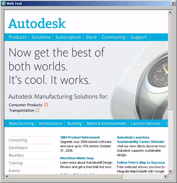

Now, if your computer has Internet access, the Web Browser displays the Autodesk homepage:
A Web Browser requires at least an address text field so that the user can enter other URLs. You can easily transform our first script into a more advanced Web Browser by adding a MAXScriptedittext control and some event handlers:
SCRIPT |
rollout webbrowser_rollout "Web Test" width:600 height:600 ( edittext edt_url "URL:" text:"http://www.autodesk.com" dotNetControl wb "System.Windows.forms.WebBrowser" pos:[10,22] width:580 height:570 fn openURL urlString = ( wb.url = dotNetObject "System.Uri" urlString ) on edt_url entered txt do openURL txt on webbrowser_rollout open do openURL edt_url.text ) createdialog webbrowser_rollout |
Try typing in other URLs in the text field and see your Web Browser opening them.
