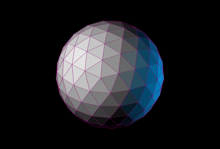

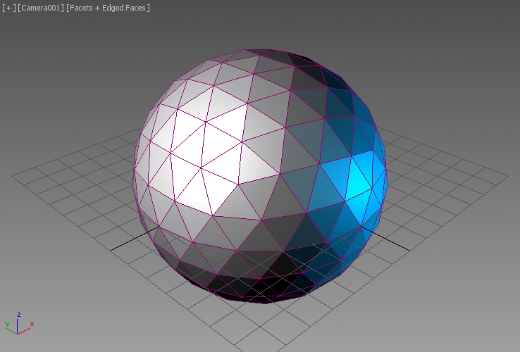

Let's render once again the same Geosphere as before, but this time lit by two Omni lights - one white on the left, and one blue and with a lower Multiplier on the right.
The left image is the screenshot of the viewport set to Facets + Edged Faces mode. The right image shows the render output of our SVG script:

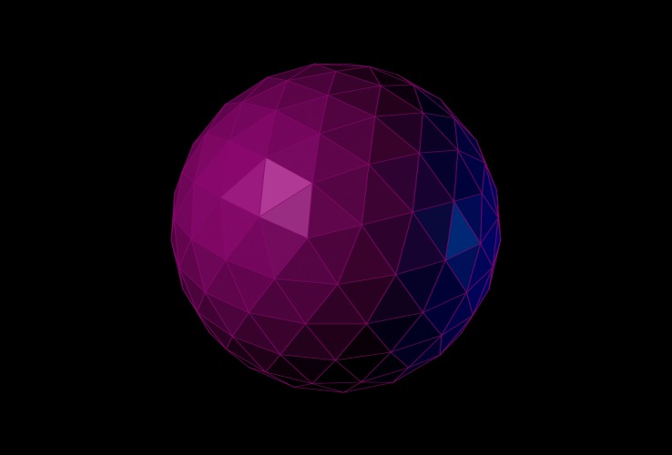

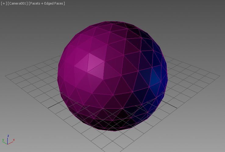

Let's see how this changes when we assign a default Standard Material to this object.
The Fill color of the faces will now be taken from the Diffuse color of the material, while the Stroke color will be taken from the .wirecolor property:

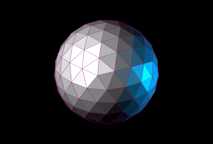

The default Standard Material has a Specular Level of 0, so there is no Specular component in the above rendering.
Let's increase the Specular Level to 100, and change the Glossiness to 20.

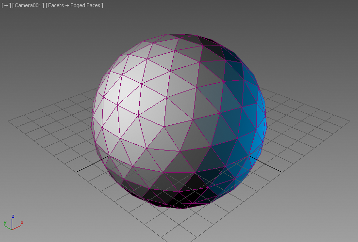

It is very easy to modify the script to render without edged faces - simply set the edge color to the lit fill color!
append drawArray #(v1, v2, v3, (ColorToHex theLitFillColor), (ColorToHex theLitFillColor), theZDepth)
As you can see, our script's output matches very closely the representation of the same object in the viewport:
