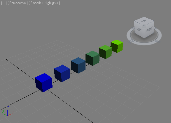

Let's expand the script we started in the beginning of this lesson:
EXAMPLE SCRIPT |
resetMaxFile #noprompt --reset the scene mybox = box length:10 width:10 height:10 wirecolor:blue --new box for i = 1 to 5 do --repeat five times, for each iteration do: ( box_copy = copy mybox --create a copy of the original box box_copy.pos = [i*20, 0, 0] --place it i*20 units along x box_copy.wirecolor = [i*25,i*50,(5-i)*50] --blue-green gradient )--end of the for loop |
Everything inside of the parentheses makes up a "block". All loop statements must be created as a block. This statement executes five times. Each time, a new box copy is created, placed to a new position and its color is changed.
A for statement starts with the word 'for'.
Next, you must define how many times the statement will repeat. In this case, we have used the variable "i" to control the loop. The line, "for i = 1 to 5" tells MAXScript to set the variable "i" to the value 1, execute the contents of the loop body, then set the variable "i" to 2, execute the loop body, and so on.
The variable "i" is called the index for the loop. Each time the loop executes, the index is incremented by 1 automatically, without requiring any user input. Each repetition of the loop is called an iteration.

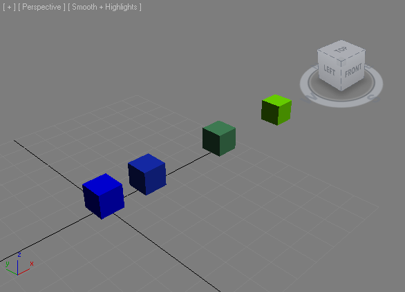

To make MAXScript increment the index by a value other than 1, insert 'by x' after the index statement, where x is the amount to increment the index by.
The following statement will set the index to 1, then 3, then 5,
FOR EXAMPLE |
resetMaxFile #noprompt --reset the scene mybox = box length:10 width:10 height:10 wirecolor:blue --new box for i = 1 to 5 by 2 do --repeat with step of 2: ( box_copy = copy mybox --create a copy of the original box box_copy.pos = [i*20, 0, 0] --place it i*20 units along x box_copy.wirecolor = [i*25,i*50,(5-i)*50] --blue-green gradient )--end of the for loop |

Note how the index was used within the loop statement to set the position of each new box by multiplying by an offset value. This is a useful way to work with multiple object creation. The same approach was used for the color, changing the R, G and B components based on the index.

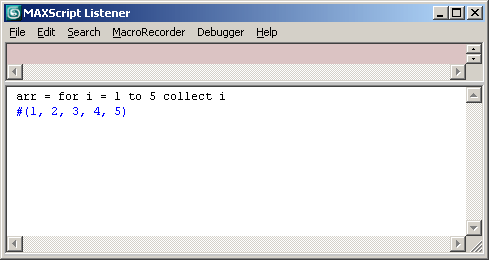

For loops can also be used to build arrays and/or access values within an array. In the following example, you use a for loop to build an array called 'arr':
Remember that because MAXScript is an expression-based language, you are able to use expressions in variable assignment, as seen above in the assignment of the for loop expression to the variable, arr.
Note the 'collect' statement in the for loop above. This tells MAXScript to collect the results of each iteration in an array, rather than just calculate them. In this case, you only asked MAXScript to collect the value of the index; however, you can collect iterations of any expression.

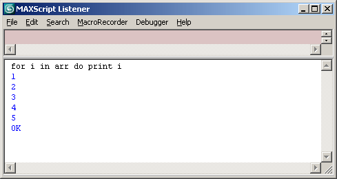

Finally, for loops can also perform iterations with the contents of an array. In the following example, you use a for loop to access the values of the array you created in the previous example:
The 'print' command is a MAXScript function that displays the specified variable in the Listener window. In this example you used 'in' instead of an equal sign; however, they are still both acceptable, even when accessing values within an array.
