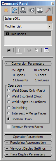

Conversion Parameters
Conversion
convertToJoinBodies <node>
Converts the specified geometry to a Join_Bodies.
Operation
<Join_Bodies>.BrepOperation (NURBS_Creation_Radio) : integer
Get/set the state of the Operation radio buttons.
Valid values are:
0 - Weld Edges Only (Fast)
1 - Weld Edges To Surface
2 - Do Nothing
3 - Intersect+Merge Faces
4 - Boolean Union
5 - Weld Into Solid (Slow)

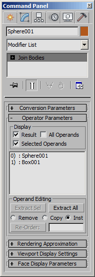

Operator Parameters
Display
<Join_Bodies>.ShowResultOP (Show_Result__Hide_Ops) : boolean
Get/set the state of the Result checkbox.
<Join_Bodies>.ShowAllOperandsOP (Show_Ops__Hide_Result) : boolean
Get/set the state of the All Operands checkbox.
<Join_Bodies>.ShowSelectedOperandsOP (Show_Selected_Operands) : boolean
Get/set the state of the Selected Operands checkbox.

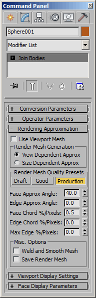

Rendering Approximation
<Join_Bodies>.RenderViewportMeshRA (Render_Viewport_Mesh) : boolean
Get/set the state of the Use Viewport Mesh checkbox.
Render Mesh Generation
<Join_Bodies>.RenderRadioRA (Render_Radio) : integer
Get/set the state of the Render Mesh Generation radio buttons.
Possible values are:
0 - View Dependent Approx.
1 - Size Dependent Approx. (default)
Render Mesh Quality Presets
<Join_Bodies>.LowQualityRA (LowQuality) : boolean
Get/set the state of the Draft checkbutton.
<Join_Bodies>.MediumQualityRA (MediumQuality) : boolean
Get/set the state of the Good checkbutton.
<Join_Bodies>.HighQualityRA (HighQuality) : boolean
Get/set the state of the Production checkbutton.
Approximation
<Join_Bodies>.FaceApproxAngleRA (Face_Angle) : float
Get/set the Face Approx. Angle value.
<Join_Bodies>.EdgeApproxAngleRA (Edge_Angle) : float
Get/set the Edge Approx. Angle value.
<Join_Bodies>.FaceChordRA (Face_Chord) : float
Get/set the Face Chors %/Pixels value.
<Join_Bodies>.EdgeChordRA (Edge_Chord) : float
Get/set the Edge Chord %/Pixels value.
<Join_Bodies>.MaxEdgeRA (Edge_Length_Rendering) : float
Get/set the Max.Edge %/Pixels value.
Misc. Options
<Join_Bodies>.WeldAndSmoothRA (Weld_and_Smooth) : boolean
Get/set the state of the Weld And Smooth Mesh checkbox.
<Join_Bodies>.SaveRenderMeshRA (Save_Render_Mesh) : boolean
Get/set the state of the Save Render Mesh checkbox.

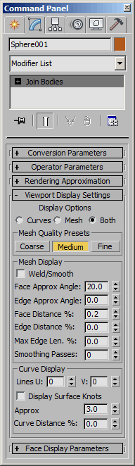

Viewport Display Settings
<Join_Bodies>.DisplayRadioVDS (Display_Radio) : integer
Get/set the state of the Display Options radio buttons.
0 - Curves
1 - Mesh
2 - Both (default)
<Join_Bodies>.LowQualityVDS (LowQuality) : boolean
Get/set the state of the Coarse checkbutton.
<Join_Bodies>.MediumQualityVDS (MediumQuality) : boolean
Get/set the state of the Medium checkbutton.
<Join_Bodies>.HighQualityVDS (HighQuality) : boolean
Get/set the state of the Fine checkbutton.
Mesh Display
<Join_Bodies>.CleanMeshVDS (CleanMesh) : boolean
Get/set the state of the Weld/Smooth checkbox.
<Join_Bodies>.FaceApproxAngleVDS (Face_Approx__Angle) : float
<Join_Bodies>.EdgeApproxAngleVDS (Edge_Approx__Angle) : float
<Join_Bodies>.FaceChordHeightVDS (Face_Chord_Height) : float
Get/set the Face Distance % value.
<Join_Bodies>.EdgeChordHeightVDS (Edge_Chord_Height) : float
Get/set the Edge Distance % value.
<Join_Bodies>.MaxEdgeLengthPctVDS (Edge_Length) : float
Get/set the Max.Edge Len. % value.
<Join_Bodies>.SmoothingPassesVDS (Smoothing_Passes) : float
Get/set the Smoothing Passes value.

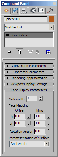

Face Display Parameters
No Properties Exposed.
