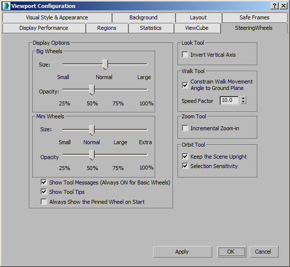

The SteeringWheelsOps Interface exposes the Steering Wheels viewport navigation feature's settings to MAXScript.
Available in 3ds Max 2009 and higher.

Display Options
SteeringWheelsOps.LargeWheelSize : integer : Read|Write
Get/set the Big Wheels Size value.
Values are in the range from 1 (Small) to 256 (Extra). Normal is 128.
SteeringWheelsOps.LargeWheelOpacityFactor : double : Read|Write
Get/set the Big Wheels Opacity value.
Values are in the range from 0.5d (25%) to 3.0d (100%).
1.0d corresponds to 50%.
2.0d corresponds to 75%.
SteeringWheelsOps.MiniWheelSize : integer : Read|Write
Get/set the Mini Wheels Size value.
64 corresponds to Normal.
128 corresponds to Large.
SteeringWheelsOps.MiniWheelOpacityFactor : double : Read|Write
Get/set the Mini Wheels Opacity value.
SteeringWheelsOps.ShowHUDMessages : bool : Read|Write
Get/set the state of the "Show Tool Messages (Always ON for Basic Wheels)" checkbox.
SteeringWheelsOps.ShowToolTips : bool : Read|Write
Get/set the state of the "Show Tool Tips" checkbox.
SteeringWheelsOps.AlwaysShowWelcome : bool : Read|Write
Get/set the state of the "Always Show the Pinned Wheel on Start" checkbox.
SteeringWheelsOps.HaveShownWelcome : bool : Read|Write
Get/set whether the Welcome screen has been shown already.
Look Tool
SteeringWheelsOps.InvertVerticalAxis : bool : Read|Write
Get/set the state of the "Invert Vertical Axis" checkbox.
Walk Tool
SteeringWheelsOps.ConstrainWalk : bool : Read|Write
Get/set the state of the "Constrain Walk Movement Angle to Ground Plane"
SteeringWheelsOps.SpeedFactor : double : Read|Write
Get/set the Walk Tool's "Speed Factor" value.
Zoom Tool
SteeringWheelsOps.IncrementalZoom : bool : Read|Write
Get/set the state of the "Incremental Zoom-in" checkbox.
Orbit Tool
SteeringWheelsOps.PreserveSceneUp : bool : Read|Write
Get/set the state of the "Keep Scene Upright" checkbox. It controls whether to use the world Z axis as an up vector when orbiting using the Steering Wheel controls.
SteeringWheelsOps.SelectionSensitivity : bool : Read|Write
Get/set the state of the "Selection Sensitivity" checkbox.
Active
SteeringWheelsOps.IsActive : bool : Read|Write
Get/set the Steering Wheel active state. When set to true, the Steering Wheel will be displayed in the viewports. When set to false, the Steering Wheel will be disabled.
