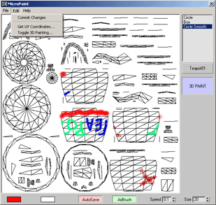

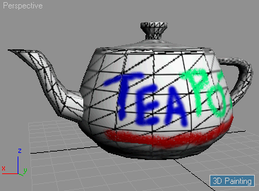

How To > Develop a Bitmap Painting Tool- 3D Painting |
In this even more exciting step of the Bitmap Painting tool development, we will add the option to directly paint on a scene object in the 3ds Max viewports.
NATURAL LANGUAGE |
We will add a new checkbutton to the User Interface to enable and disable the 3D Painting. |
We will define a couple of simple functions using thePainterInterface to control the brush in the viewport, read the UV coordinates of the faces it is painting, and draw in the corresponding area of the bitmap. |
SCRIPT: |

fn StartStroke = ( thePainterInterface.undoStart() )
fn PaintStroke =
theMesh = theObj.mesh
thePainterInterface.getHitFaceData &bary &faceIndex theObj 0
theFace = meshop.getMapFace theMesh theChannel faceIndex
vert1= meshop.getMapVert theMesh theChannel theFace.x
vert2= meshop.getMapVert theMesh theChannel theFace.y
vert3= meshop.getMapVert theMesh theChannel theFace.z
thePoint = bary.x*vert1 + bary.y*vert2 + bary.z*vert3
drawStroke [thePoint.x * bitmapx_1, bitmapy_1 - thePoint.y * bitmapy_1] [thePoint.x * bitmapx_1, bitmapy_1 - thePoint.y * bitmapy_1]
thePainterInterface.clearStroke()
fn EndStroke =
thePainterInterface.undoAccept()
if autoSave.checked do
save theCanvasBitmap
try(theObj.material.diffsemap.bitmap = theCanvasBitmap)catch()
fn CancelStroke = (thePainterInterface.undoCancel())
fn SystemEndPaintSession = ( paint3D.checked = false )
fn startPainting3D =
if thePainterInterface.InPaintMode() or theObj == undefined then
thePainterInterface.EndPaintSession()
else
paint3D.checked = true
thePainterInterface.pointGatherEnable = TRUE
thePainterInterface.initializeNodes 0 #(theObj)
thePainterInterface.offMeshHitType = 2
thePainterInterface.ScriptFunctions startStroke paintStroke endStroke cancelStroke SystemEndPaintSession
thePainterInterface.startPaintSession()
on paint3D changed state do startPainting3D()

--Code in italic has no changes since the previous version macroScript MicroPaint category:"HowTo" ( global MicroPaint_CanvasRollout try(destroyDialog MicroPaint_CanvasRollout)catch() local isErasing = isDrawing = false local bitmapX = bitmapY = 512 local bitmapx_1 = bitmapx-1 local bitmapy_1 = bitmapy-1 local temp_bitmap_filename = (getDir #preview +"/microPaint_temp.tga") local theCanvasBitmap = bitmap bitmapX bitmapY color:white filename:temp_bitmap_filename local theBackgroundBitmap = bitmap bitmapX bitmapY color:white local currentPos = lastPos = [0,0] local theChannel = 1 local theObj = undefined local bary = [0,0,0]
This variable will be used by the PainterInterface to return the Barycentric Coordinates of the hit point inside the face.
local faceIndex = 1
This variable will be used by the PainterInterface to return the index of the face that has been hit.
rcMenu CanvasMenu ( subMenu "File" ( menuItem new_menu "New" menuItem open_menu "Open..." menuItem save_as "Save As..." separator file_menu_1 menuItem quit_tool "Quit" ) subMenu "Edit" ( menuItem commit_menu "Commit Changes" separator edit_menu_1 menuItem uv_menu "Get UV Coordinates..." menuItem paint3d_menu "Toggle 3D Painting..."
This is the new "Toggle 3D Painting" menu item. We will also add a very prominent button to the main User Interface...
) on commit_menu picked do copy theCanvasBitmap theBackgroundBitmap on uv_menu picked do MicroPaint_CanvasRollout.unwrapTexture() on paint3d_menu picked do MicroPaint_CanvasRollout.startPainting3D()
This is the handler of the new "Toggle 3D Painting" menu item. It calls a function that will toggle the PainterInterface on and off.
subMenu "Help"
menuItem about_tool "About MicroPaint..."

checkbutton paint3D "3D PAINT" width:90 height:50 highlightcolor:(color 200 200 255) pos:[bitmapX+5,180]
This is the new checkbutton controlling the painting in 3D space. It will turn blue when enabled.

on MicroPaint_CanvasRollout lbuttondown pos do ( lastPos = pos isDrawing = true isErasing = false drawStroke lastPos pos ) on MicroPaint_CanvasRollout rbuttondown pos do ( lastPos = pos isErasing = isDrawing = true drawStroke lastPos pos ) on MicroPaint_CanvasRollout lbuttonup pos do ( isErasing = isDrawing = false if autoSave.checked do save theCanvasBitmap ) on MicroPaint_CanvasRollout rbuttonup pos do ( isErasing = isDrawing = false if autoSave.checked do save theCanvasBitmap ) on autoSave changed state do if state do save theCanvasBitmap on MicroPaint_CanvasRollout mousemove pos do ( if isDrawing do drawStroke lastPos pos lastPos = pos ) ) createDialog MicroPaint_CanvasRollout (bitmapx+100) (bitmapy+30) menu:CanvasMenu MicroPaint_CanvasRollout.theCanvas.bitmap = theBackgroundBitmap )
RESULT: |
You can paint on both the 3D object and the 2D image at the same time.
