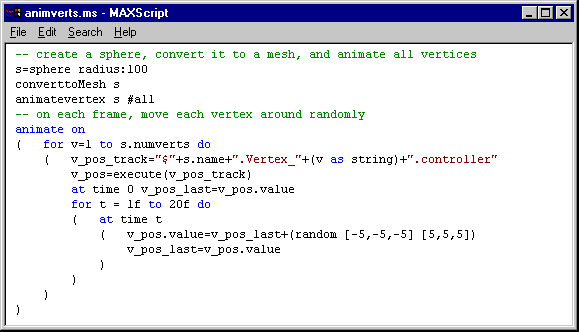

MAXScript Editor windows are text editor windows that you can open within 3ds Max and use to create or edit text files, notably MAXScript script files. Press Open Script on the MAXScript rollout, File > Open Script in the Listener menu bar, or MAXScript > Open Script in the 3ds Max menu bar to open an existing script file. MAXScript opens the selected script in a modeless MAXScript Editor window like the one shown.
To create a new script, press New Script on the MAXScript rollout, File > New Script in the Listener menu bar, or MAXScript > New Script in the 3ds Max menu bar to open a new empty MAXScript Editor window. You can write and edit text including drag-and-drop editing in the MAXScript Editor as you can in other editors like WordPad. The menus are similar to those in many standard Windows text editors. You can have any number of MAXScript Editor windows open at the same time.
