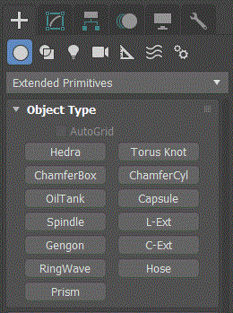

Gengon : GeometryClass
Gengon - superclass: GeometryClass; super-superclass:node - classID: #(1237277087, 905528747)
Value > MAXWrapper > Node > GeometryClass > Gengon
