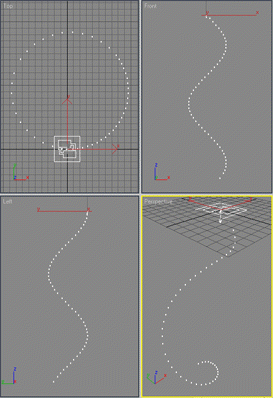

Effect:
The script modifies particle speed and direction, causing particles to follow a spiral path:
EXAMPLE |
--Get the current particle system executing the script pf_node_current = particleFlow.scriptRunner() --In case the current particle system is a valid node if (pf_node_current != undefined) then ( --Get the total number of particles count = pf_node_current.NumParticles() --Loop from 1 to the number of particles for i in 1 to count do ( --Set the particle index in the container to the current i value. --This makes the i-th particle in the container the current one: pf_node_current.particleIndex = i --Get the age of the particle, multiply by 5 and use as angle --to define the particle speed --Decreasing the constant 5 will slow down the rotation --Increasing the constant will speed up the rotation age = 5*pf_node_current.particleAge --Calculate the speed of the particle using the --function of the circle. --Info: In general, a circle can be drawn using an Angle --going from 0 to 2*Pi and the following functions for X and Y: --X = CenterX+Radius*Cos(Angle) --Y = CenterY+Radius*Sin(Angle) --In our case, CenterX and CenterY are 0, Radius is 0.05 units, --and Angle is based on the Age of the particles (see above). --Changing the constant 0.05 will change the radius of the path. --Changing the -0.05 (Z speed) will change the height of the spiral. pf_node_current.particleSpeed = [0.05*cos(age), 0.05*sin(age), -0.05] )--end i loop )--end if |
