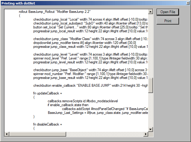

Define a MaxForm using the MaxCustomControls assembly containing a text box and two buttons.
Implement a function to print a text file to be called by the Print button's event handler.
Implement a function to open a text file when the event handler of the Open File button is called.
Register the event handlers.
Ensure the event handlers will not be garbage collected.

Step-By-Step
dotNet.loadAssembly "MaxCustomControls.dll"
We load a custom assembly containing 3ds Max specific controls.
local filetoprint = ""
This variable will store the name of the file to print.
local printFont = dotnetobject "System.Drawing.Font" "Arial" 10
We create an object instance of the System.Drawing.Font class with font name Arial and size of 10 and store the object in the user variable for later use.
local streamReader
This user variable will hold the stream reader.
hForm = dotNetObject "MaxCustomControls.MaxForm"
Let's create our main form.

hForm.Controls.Add(txtTextBox)
hForm.Controls.Add(btnOpenFile)
hForm.Controls.Add(btnPrint)
We can also add the textbox and the two buttons to the form.
dotnet.setLifetimeControl btnOpenFile #dotnet
dotnet.setLifetimeControl btnPrint #dotnet
Since we are adding scripted event handlers to the DotNet controls and placing those controls in a form whose lifetime is longer than the MAXScript values wrapping the controls, we set the lifetime control of the buttons to be controlled by DotNet
You might ask:
Is there any reason this isn’t the default behavior when creating event handlers?
Yes, the above approach is only applicable to DotNet objects that are placed in other DotNet objects.
An example of when you have an event handler and you do not want the object’s lifetime control to change is a timer object. You want the timer object to be deleted when the MAXScript value wrapping the object is deleted. If you set the timer object’s lifetime control to #dotnet, then at some random point in the future the timer object will be deleted by the DotNet garbage collector since no DotNet object holds a reference to the timer object.
hForm.ShowModeless()
Finally, we show the form.
)--end script
Result
