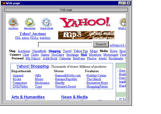

The following example creates an Internet Explorer browser control in a rollout and registers it as extended viewport.
Pick "Web Page" from the Extended Views menu to display the rollout in the webpage. Also click various hypertext links to see the text change in the viewports
