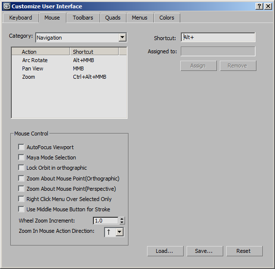

This Core Interface exposes the Mouse Configuration Manager to MAXScript.
It allows the behavior of the mouse within the viewports to be customized and adapted to various user workflows, including the emulation of Autodesk Maya mouse controls.
Available in 3ds Max 2013 and higher.
See also the related Interface IInteractionMode which exposes the Interaction Mode tab of the Preference Settings dialog.

MouseConfigManager.AutoFocusViewportOnKeyPress : bool : Read|Write
Get/set the auto-focus viewport on key press behavior.
When set to false (3ds Max default), pressing a key while the mouse is over a non-active viewport will not change focus to that viewport.
When set to true (Maya default), pressing a keyboard shortcut will automatically switch focus to the viewport the mouse is over.
MouseConfigManager.MayaSelectionMode : bool : Read|Write
Get/set the state of the Maya Selection Mode option.
When set to False (default), selection will be performed using the 3ds Max default behavior.
When set to True, the Maya selection behavior will be used.
MouseConfigManager.ArcRotateLocked : bool : Read|Write
Get/set the locking of the Orbit (formerly known as Arc Rotate) feature in Orthographic viewports (e.g. Top, Bottom, Front, Back, Left, Right).
When set to False (3ds Max default), performing Orbit in an Orthographic viewport will turn it into an Orthographic (a.k.a. User) view.
When set to True (Maya default), Orbit cannot be performed in Orthographic viewports, only in viewport already set to Perspective or Orthographic.
MouseConfigManager.ZoomAboutMousePointOrthographic : bool : Read|Write
Get/set whether to zoom about the mouse point in Orthographic viewports.
MouseConfigManager.ZoomAboutMousePointPerspective : bool : Read|Write
Get/set whether to zoom about the mouse point in Perspective viewports.
MouseConfigManager.RightClickMenuOverSelectedOnly : bool : Read|Write
Get/set whether to allow the opening of QuadMenus when right-clicking anywhere in the viewport (false, default 3ds Max behavior),
or only over selected objects (true, default Maya behavior)
MouseConfigManager.MiddleMouseStrokeMode : bool : Read|Write
Get/set whether to use the mouse wheel for Strokes or Viewport Pan.
MouseConfigManager.ZoomWheelIncrement : float : Read|Write
Get/set the zoom increment when using the mouse wheel.
MouseConfigManager.ZoomInDirection : enum : Read|Write
ZoomInDirection enums: {#North|#NorthEast|#East|#SouthEast|#South|#SouthWest|#West|#NorthWest
Get/set the Zoom In mouse direction.
The 3ds Max default is #North .
The Maya default is #SouthEast
MouseConfigManager.UserMode : enum : Read|Write
UserMode enums: {#Max|#Maya|#Customized}
Get/set the current Use Mode.
Possible mode values are:
#Max - all mouse settings match the standard 3ds Max behavior
#Maya - all mouse settings match the standard Maya behavior
#Customized - the mouse settings have been customized and are a mixture of 3ds Max and Maya behaviors
