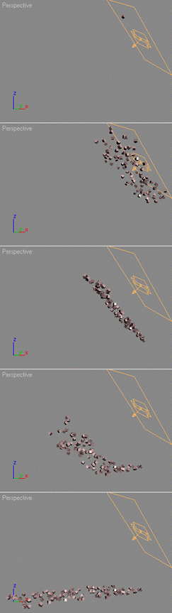

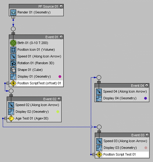

The PF_Source generates particles which get tested for relative offset of -100 to their birth position along the Z axis.
If they pass the scripted offset test, the particles are moved to the second Event which stops them and tests them for Age above 30.
If they pass the Age Test, the particles are moved to the Third event which tests them for absolute offset of -200 along the world Z axis using the second script.
If they pass the scripted position test, the particles are moved to the last Event which stops them.
