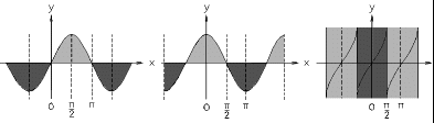

The graphs of the basic trigonometric functions illustrate their cyclical nature.
Graphs of basic trigonometric functions
The sine and cosine functions yield the same values, but the phase differs along the X-axis by /2: in other words, 90 degrees.

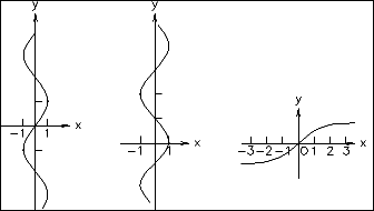

The inverse functions for the trigonometric functions are the arc functions—the inverse only applies to values of x restricted by -/2 ≤ X ≤ /2. The graphs for these functions appear like the basic trigonometric function graphs, but turned on their sides.
Graphs of basic arc functions
