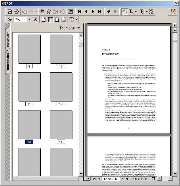

The following example will not work unless the PDF ActiveX control is registered on your system.

.LoadFile fileName:string
Load a new PDF file.
.setShowToolbar On:Boolean
When the argument is false, the toolbar will be hidden. When the argument is true, the toolbar will be displayed.
