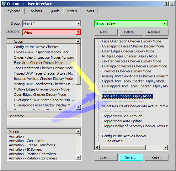

Now, that we have an xView checked and a MacroScript to control it, we can customize the Viewport Menus to add our checker to the list of available xView Checkers.
Evaluate the script by pressing Ctrl+E to create an ActionItem. A copy of the MacroScript code will be saved automatically in the \usermacros folder of 3ds Max and will be available in future 3ds Max sessions. It is NOT necessary to put the MacroScript source code in a \Startup or \Plugins folder.
At this point you can go to Main Menu > Customize > Customize User Interface and select the Menus tab in the Customize User Interface dialog.
| Color | Action |
| Red |
Select the xView Category in the left drop-down list. |
| Greeen |
Select Views - xView Menu in the right drop-down list. |
| Purple |
Drag two Separator lines to the menu. |
| Yellow |
Drag the Face Area Checker Display Mode ActionItem between the two lines. |
| Blue |
Save the Custom Interface to disk to make the changes permanent. Confirm the overwriting of the CUI file. |
