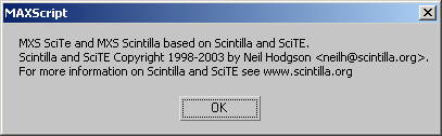

About MXS SciTE-Selecting this item opens the following about dialog:
